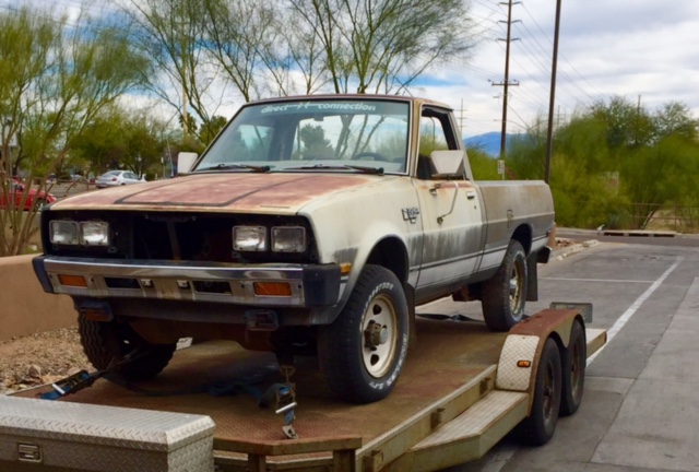

The patina on the other hand now gets the name "The Hyena" a rough looking little monster feeding off the scraps of the desert.
1984 Power Ram
Looks a bit like a rust bucket, but it's only the top and sides of the body, the underbody is clean as can be.
