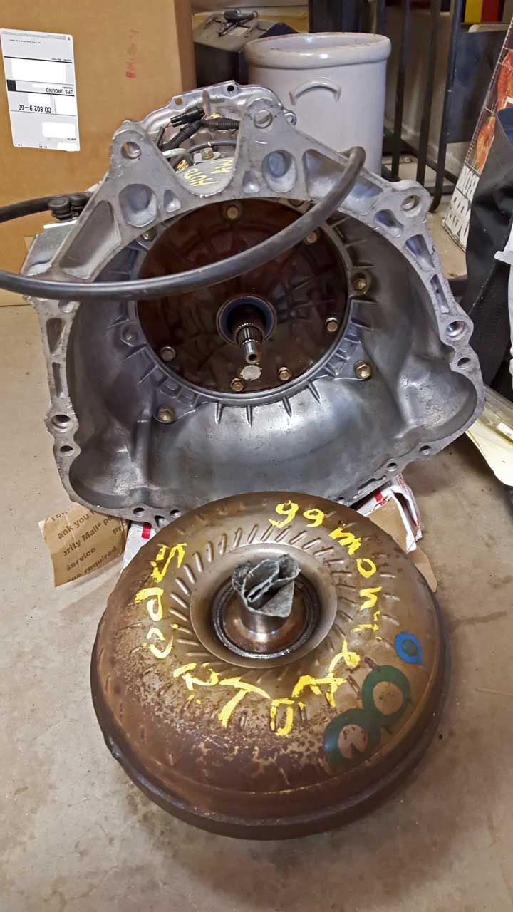

My new transmission ...
1997 Mitsubishi Montero Sport LS 4WD
Aisin AW 30-43LE
96M E 67472

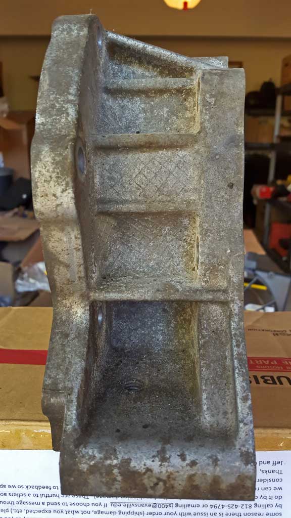

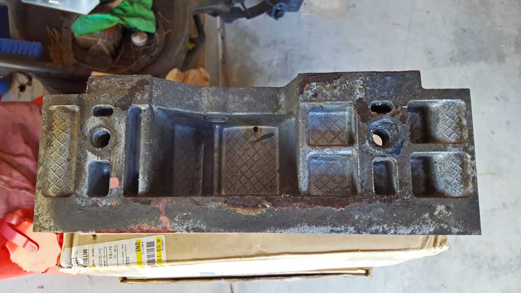

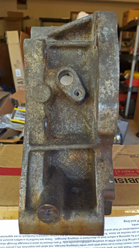

1991-2001 Jeep Cherokee XJ Aisin AW4 A/T adapter housing ...
1998-2001 Jeep Cherokee XJ Aisin AW4 A/T 23 spline output shaft ...
(not a Mitsu part, just a handy stand for photos <img src="/forums/images/graemlins/smile.gif" alt="" /> )
