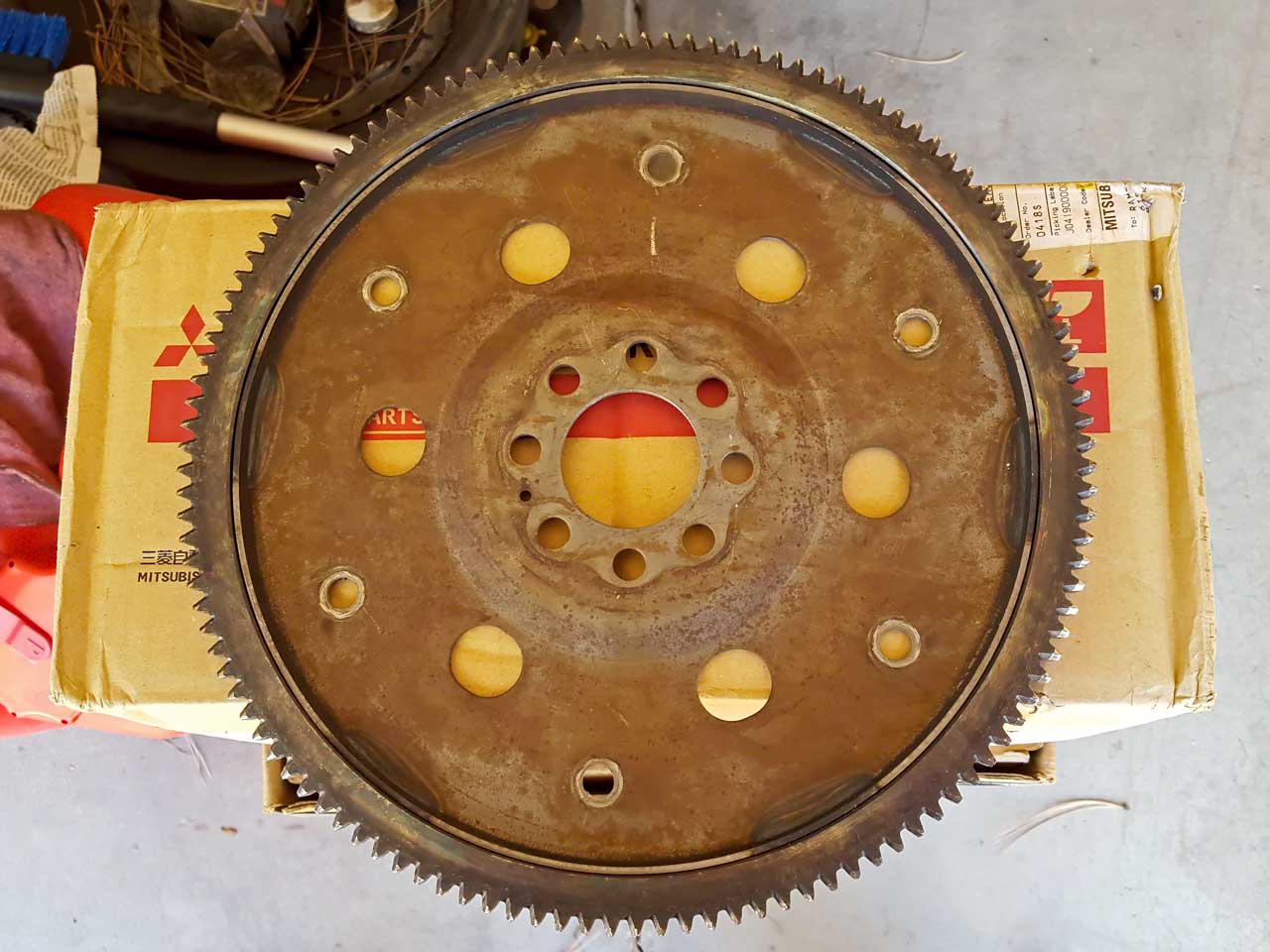

Corrected PN#s for the following ...
Mitsubishi (1997/98) -
1 - Flex plate PN# MB919250

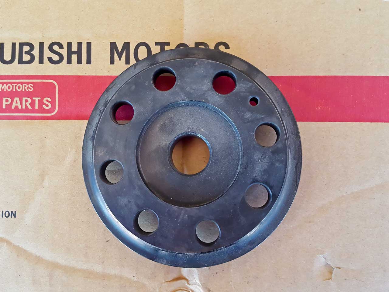

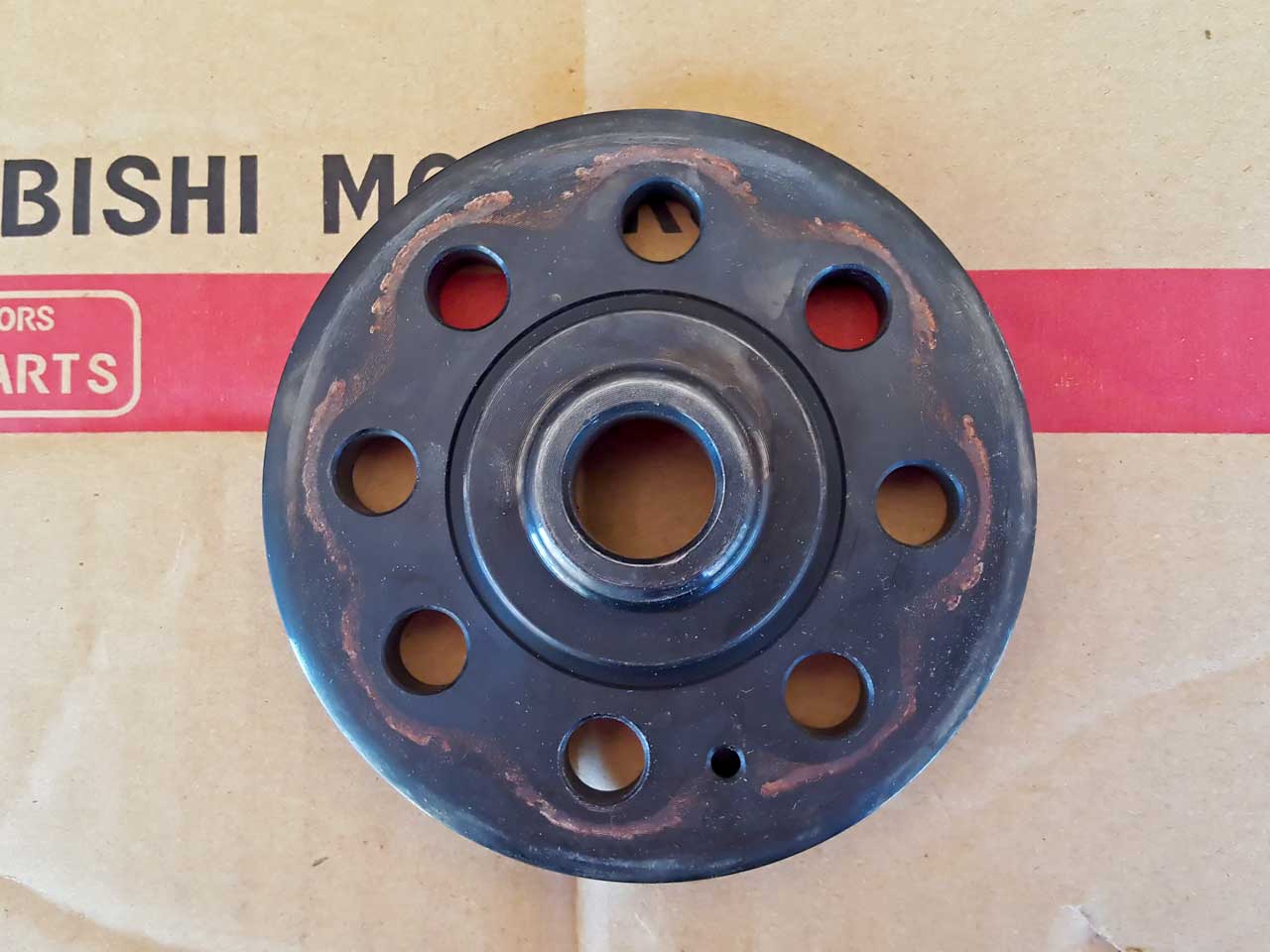

1 - Adapter plate PN# MD337494
8 - (flex plate to) Crank bolts PN# MD113400

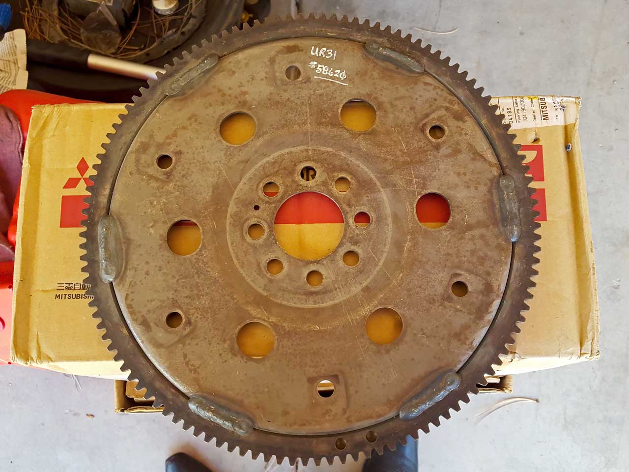

1997 A/T Flex plate
1997 A/T Crank/Flex plate spacer plate

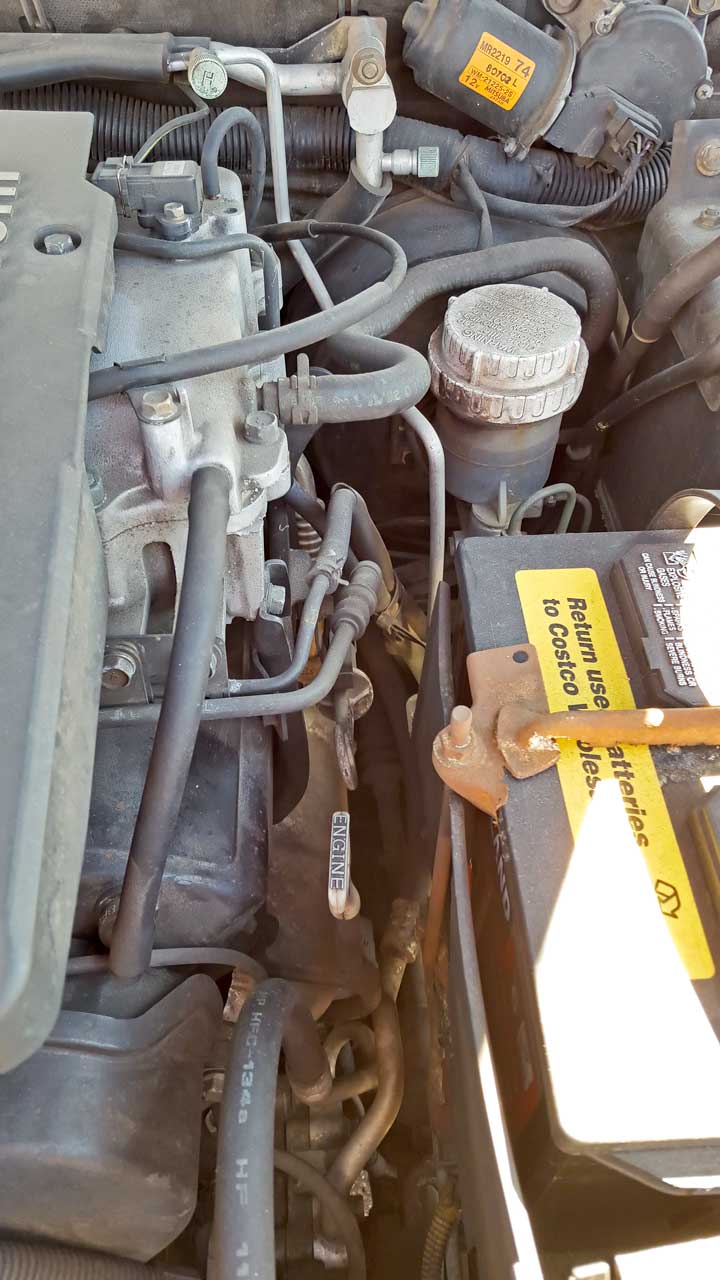

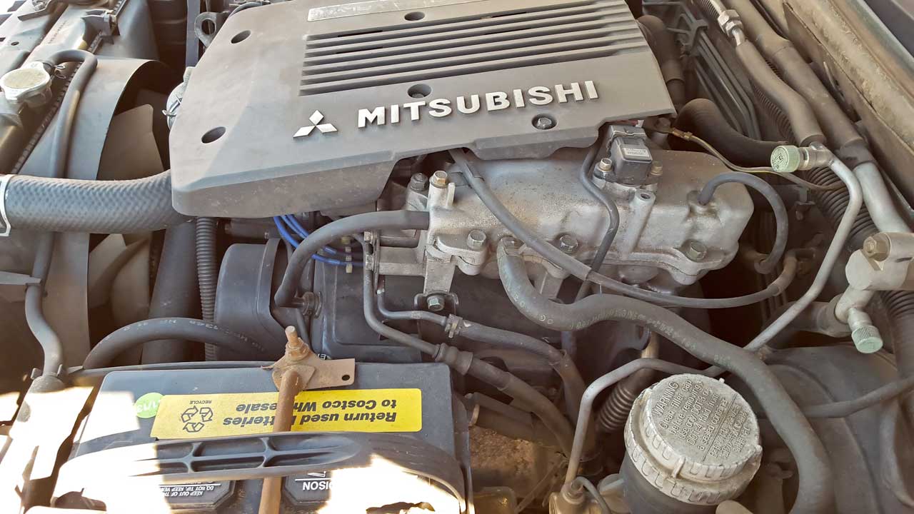

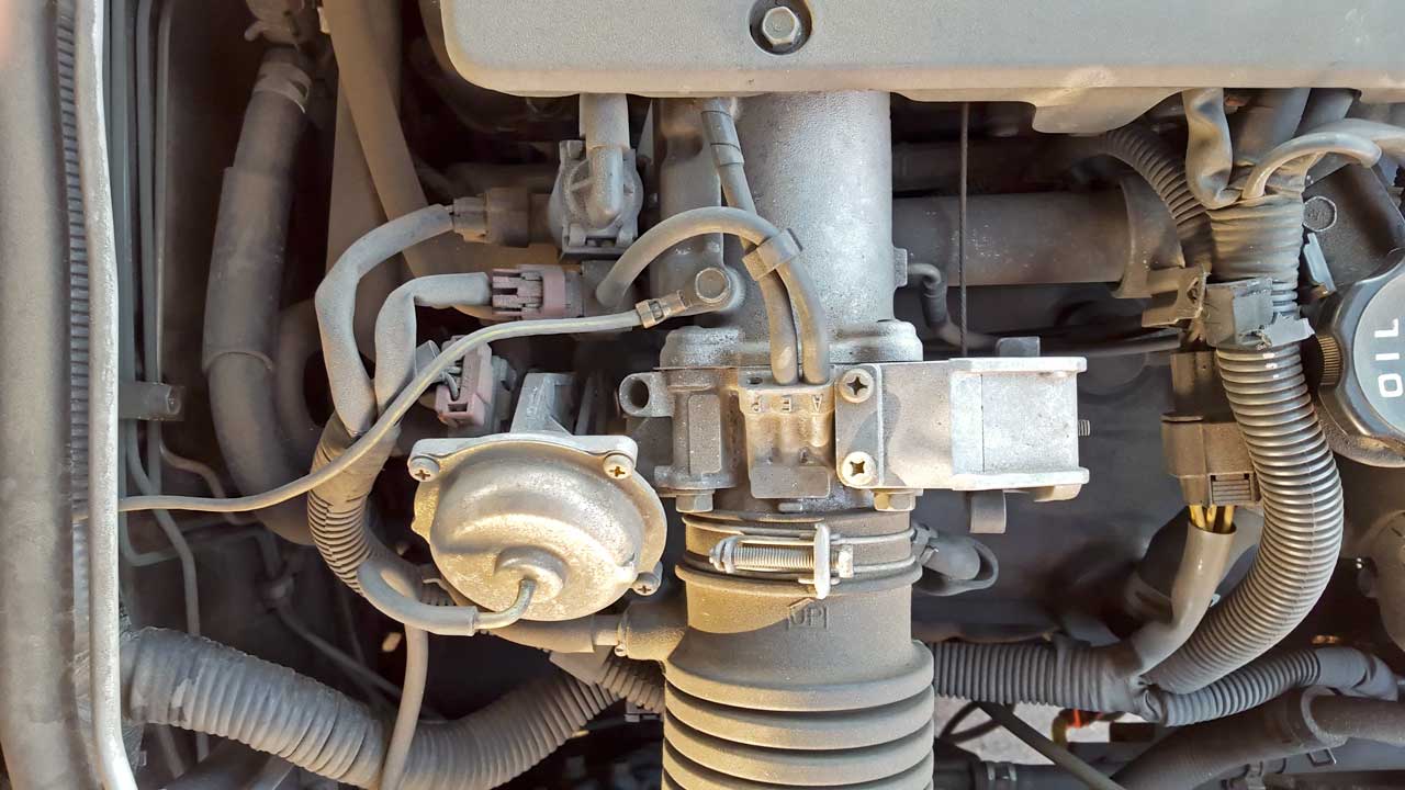

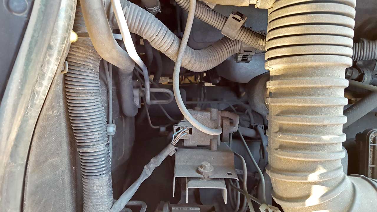

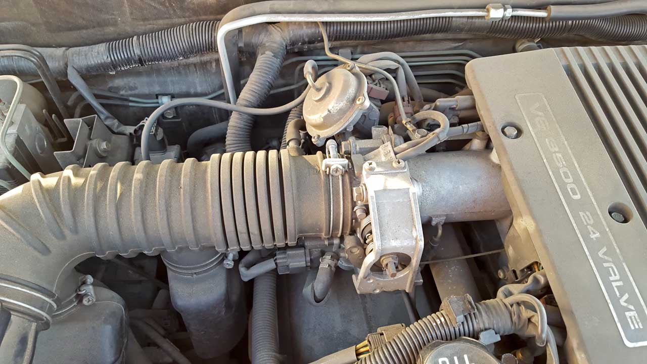

Engine bay photos of the 1999 Montero Sport Limited 3.5L. I'm still working on getting a dipstick tube for my A/T. frown After taking a good look at things, I believe I can use the Cherokee A/T pan, fill tube and dipstick. Of course, there's no way to tell if the tube will clear until I try to put it all together, but it looks like everything would be ok. The exhaust is the only thing in that passenger side firewall/engine area. The only thing that I really noticed is that the Montero/Sport tube comes up at more of an angle - ok, and its on the DR side smile - than the Cherokee which comes almost straight up into the engine bay.
