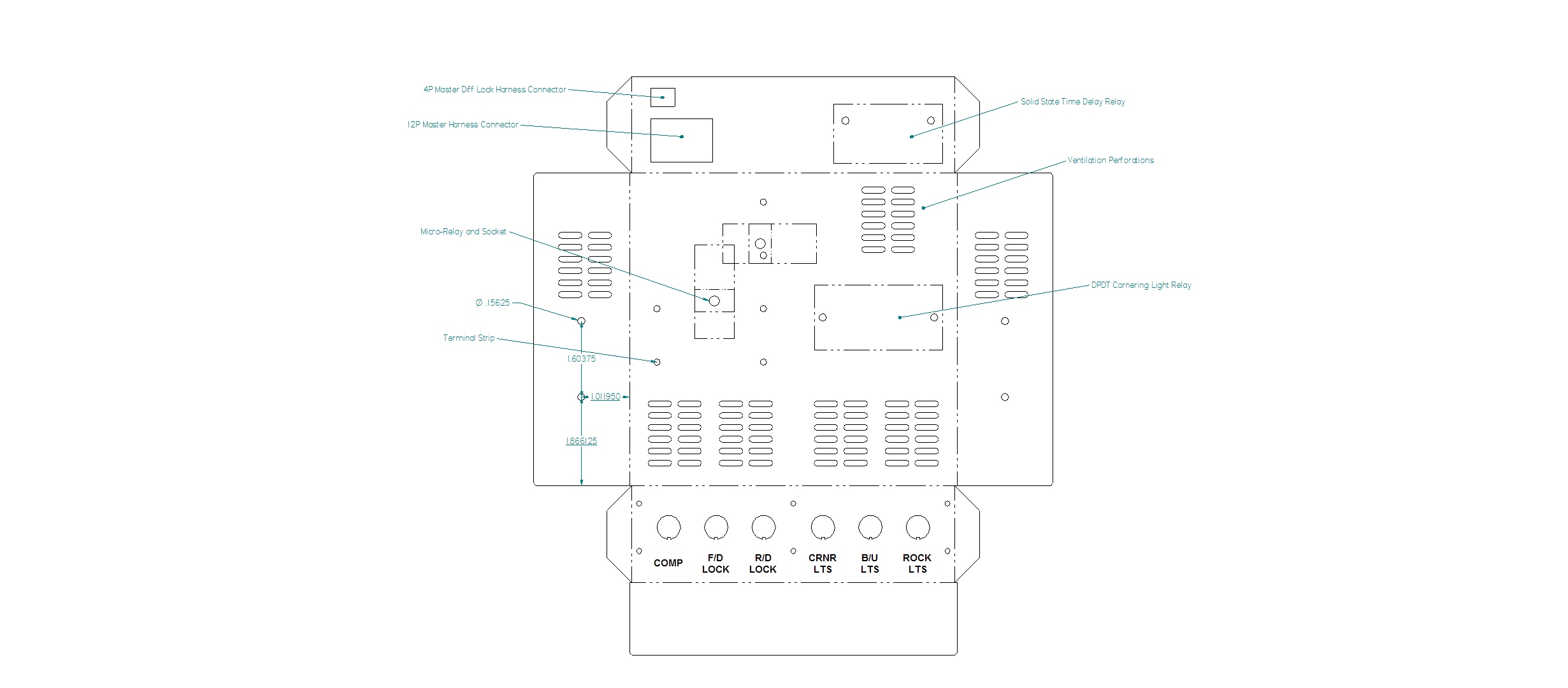

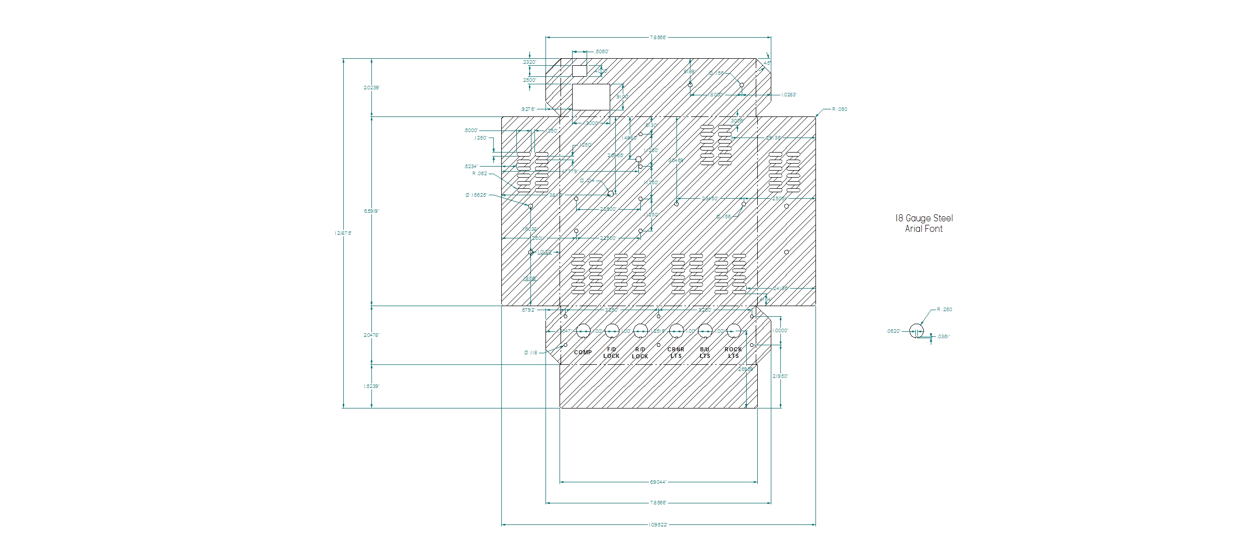

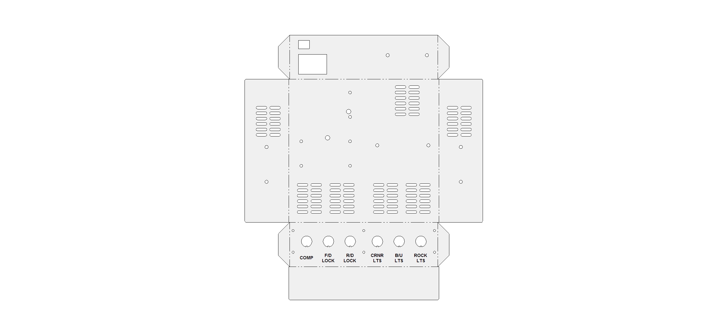

For lack of a better place to put a bunch of switches for the lighting, compressor and air lockers, I'm pulling the single CD player located in the console and installing a custom built enclosure. Its an enclosure rather than a 'panel' because it will also hold the three relays necessary for the front cornering lights and the delayed-off enclosure illumination and exterior lighting feature. The enclosure is connectorized just like the OEM CD player so it will be easily removable if I need to tech to do something under the dash.
The enclosure illumination (the switch lettering) will stay lit for 15 minutes after the ignition is turned off. The compressor and locker solenoids are powered continuously so the lockers will stay engaged even with the vehicle turned off and the key removed. I wanted the exterior lighting only powered with the ignition on or in acc - so normal OEM behavior - but I wanted the exterior lighting to stay on (if it was already on) after the vehicle was turned off for the same 15 minutes as the enclosure illumination and then automatically turn off. InPOWER supplies a nifty delayed-off relay that makes this all possible in a simple, single tiny package.
The really annoying fly in this setup is having the front and rear locker switches in the console out of easy reach. Fine for a mall-crawler, but otherwise not so good. frown I've lived for almost 15 years with the front/rear lockers in my big Sport wired together so that one switch turns both on or off and its rare that this is an issue. Mostly I wanted to be able to turn the front and rear on/off independently of each other in the this build BEFORE I hit an obstacle - not during. If I could get that functionality I'd be happy. The '99 has the OEM R/D locker so it has the switch in the left side of the dash which will be removed since I'm installing ARB air lockers. I reworked the wiring a little and found a company that will 'print' custom Carling rocker switch covers so this switch will replace the OEM locker switch and will effectively be a master on/off switch for the differentials. I can set whatever configuration at the console, and control on/off form the master switch next to the steering wheel.
The toggle switches are Carling illuminated tip - white off and red on - and the Carling rocker also has off and on illumination. I think I'll either paint or powder coat the enclosure using the black 'wrinkle' paint - I haven't looked that far ahead yet. smile If I end up having to make a custom enclosure for the shifter, I'll make them match. I'll cross that bridge when I get to it. laugh
I ran out of space on the face of the enclosure so I had to cut out one switch. I integrated the backup lights and rear corner lights into on switch figuring that if I needed one or the other, I probably needed both.
