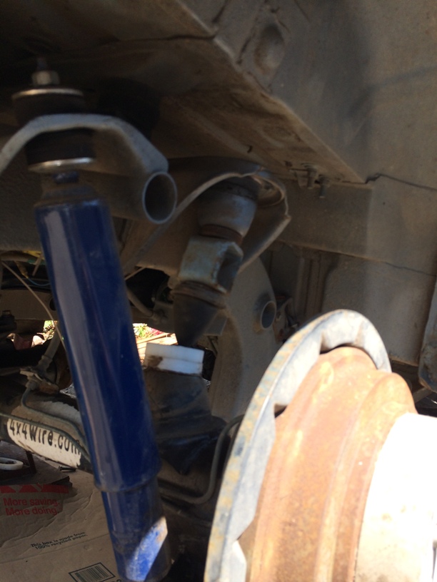

success in replacing the axle bearings(and outer seals).
had to make an interesting jumble of items to act as a press plate, to remove the bearings- installation was more conventional.

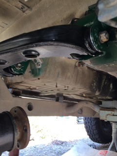

nixed the fishrun idea, and decided to strengthen the chassis- where the steeringbox bolts on.
several cracks and tears have been appearing, as if the chassis has been twisting.
got some metal plates and straps formed, and intend to weld it all together.
this could even look good.

-it certainly looks like something happened to it, and it kinda looks like i thought it should........
metalglued the plates and straps to the chassis.
expect to see if the steeringbox will still fit sometime this week.
squirted some paint to hide the repair site.

the steering box fits- still need to weld a steering limiter in place, and remount the pump&hoses&reservoir- should work.

suzi could see the 'con again- still looking like this steering breakage repair will work.
finished w/the metal glue gun(mabe) by sticking on a steering stop, so i can make her mobile again.
