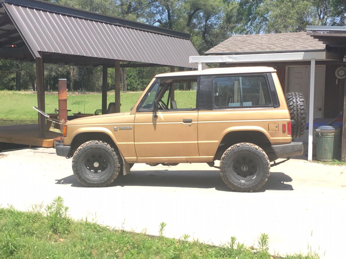

The 31" BFGs worked good but I wanted something bigger and more aggresive, so I bought an old set of 33x12.50 TSL swampers for it. I mounted them and used 10oz of airsoft BBs in each tire.
Then I thought it needed a brush guard so I bent up some rebar and made one.

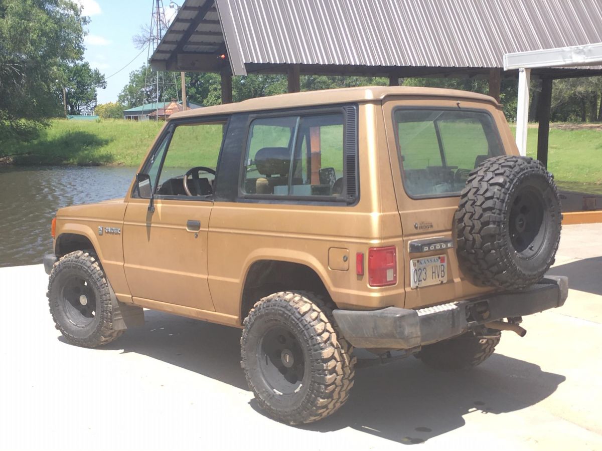

New Monroe shocks, changed diff fluid front and rear, new roof rack.
[Linked Image from magaimg.net]
Decided to remove the used 33" TSLs for a new set of Maxxis Buckshot II 33x12.50. The swampers were old and leaking around the bead. For a truck that will get used maybe 2-3 times a year on vacation, I didn't want to mess with tires.
I mounted a LED light bar in the skidplate, fixed the LEDs in the grille, and mounted flush mount LED lights in the rear bumper. New wiring and switches for the lights.
