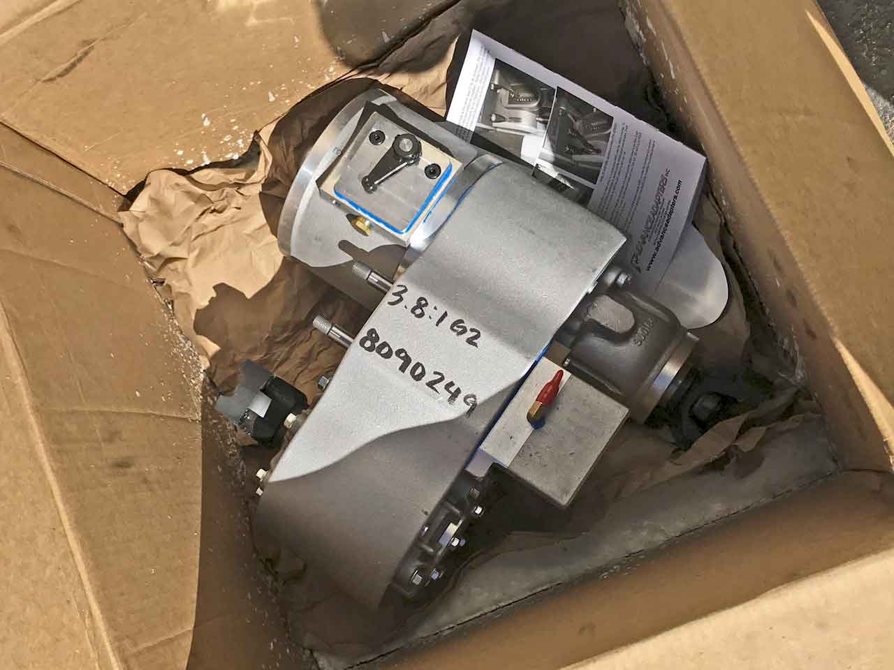

... Atlas t-case -
Gear Ratio: 10.34:1
Drop: Left hand drop (Driver Side)
Input Spline: 23 Spline short
Tailhousing: Standard Tailhousing (w/ speedo provission)
Speedometer: Electronic Speedometer Module
Rear Yoke: 1350 CV
Front Yoke: 1350 CV
Site Tube: Yes Please ....
The Atlas 4-speed transfer case showed up last week with the electronic speedometer module included as ordered. The same part is available separately from AA under "300640 : TJ SPEEDOMETER HOUSING KIT".

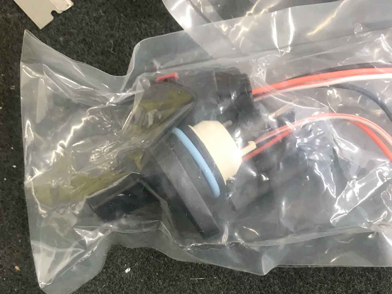

The Atlas 2 & 4 speed transfer cases (now) will accept up to two open/closed switches - exactly the same functionality as the Mitsubishi transfer case switches from 1997-2001. Installing two Atlas Low Range Switch Kits (#300378A) maintains the "2WD/4WD Detection Switch" and "Low Range Switch" functionality. Soft of. There is no switch for the doubler on the 4 Speed Atlas so something creative would have to be done there. AA suggests a toggle switch. Sigh.
Given that I'm replacing the transmission and TCM, all of this is somewhat academic, but I want to keep the 4WD indicator on the dash functional and I also want to minimize the amount of stuff going into/out of the PCM that has been disconnected or will now be non-functional. (the switches in the diagram are shown in the positions they need to occupy to function correctly)
Waiting on the axles still. frown I had to hunt all over to get a 4 PPR reluctor ring for the AW4. I can't believe how expensive the sensors are. sick

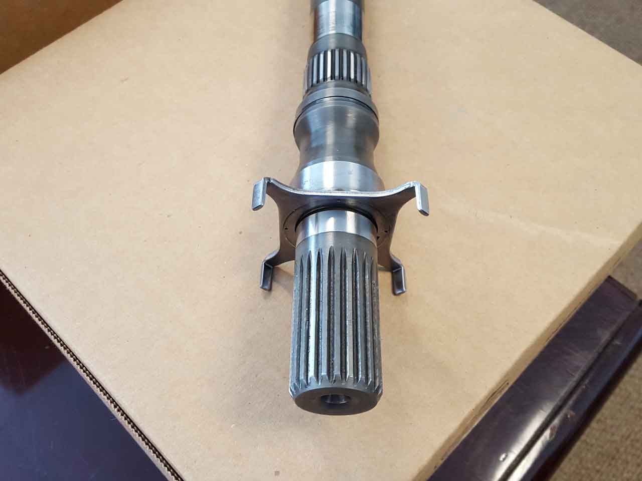

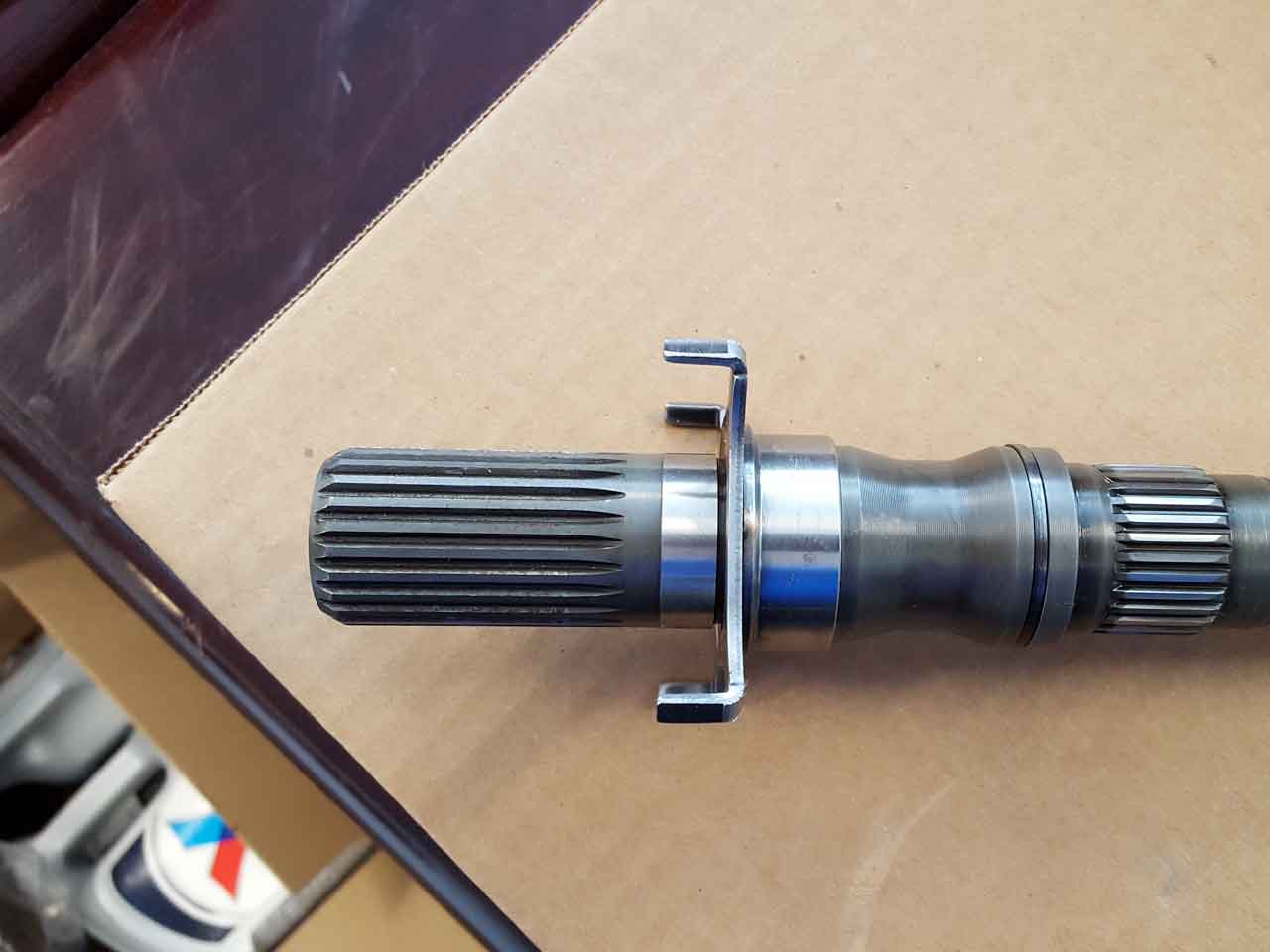

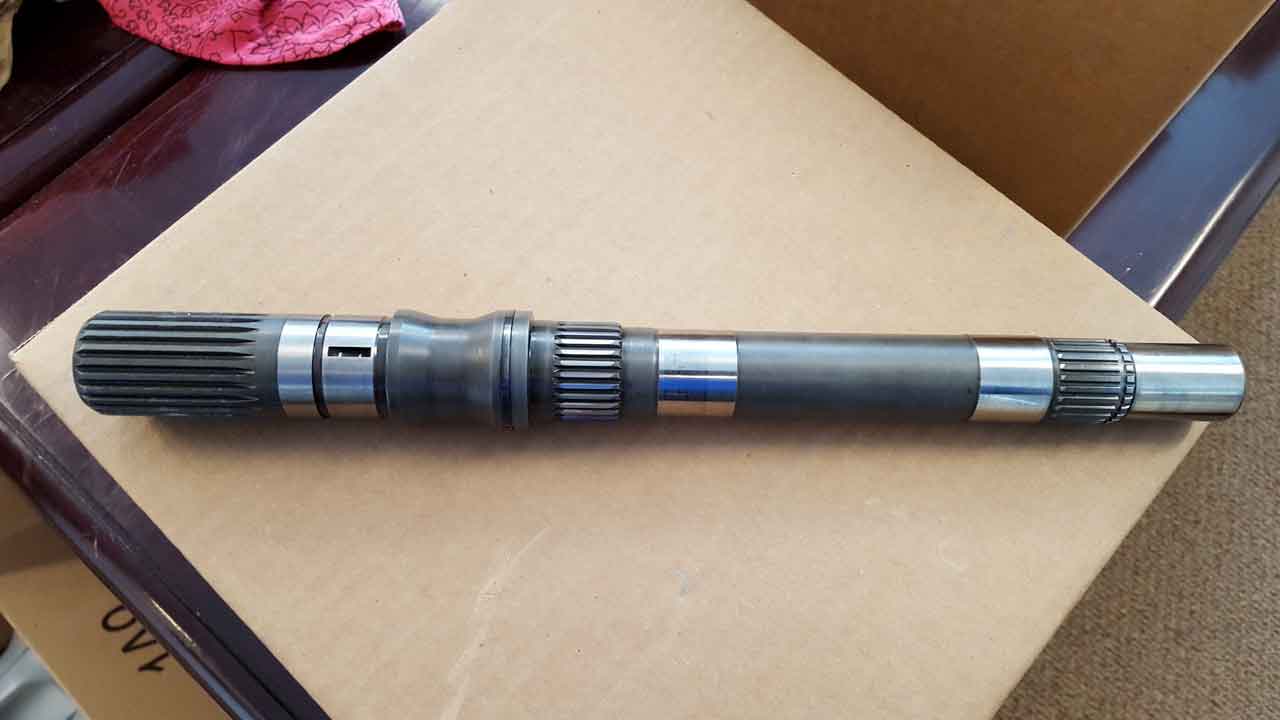

Montero Sport & Jeep A/T Output Shaft [Re: ES_97Sport] #1104264 03/26/18 08:43 PM
ES_97Sport Offline OP

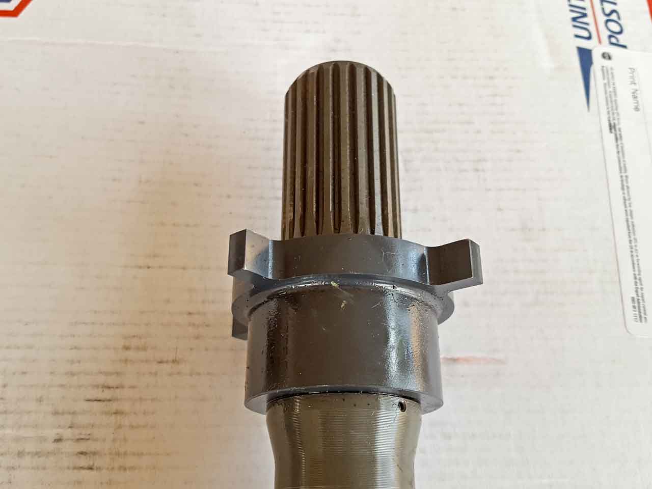

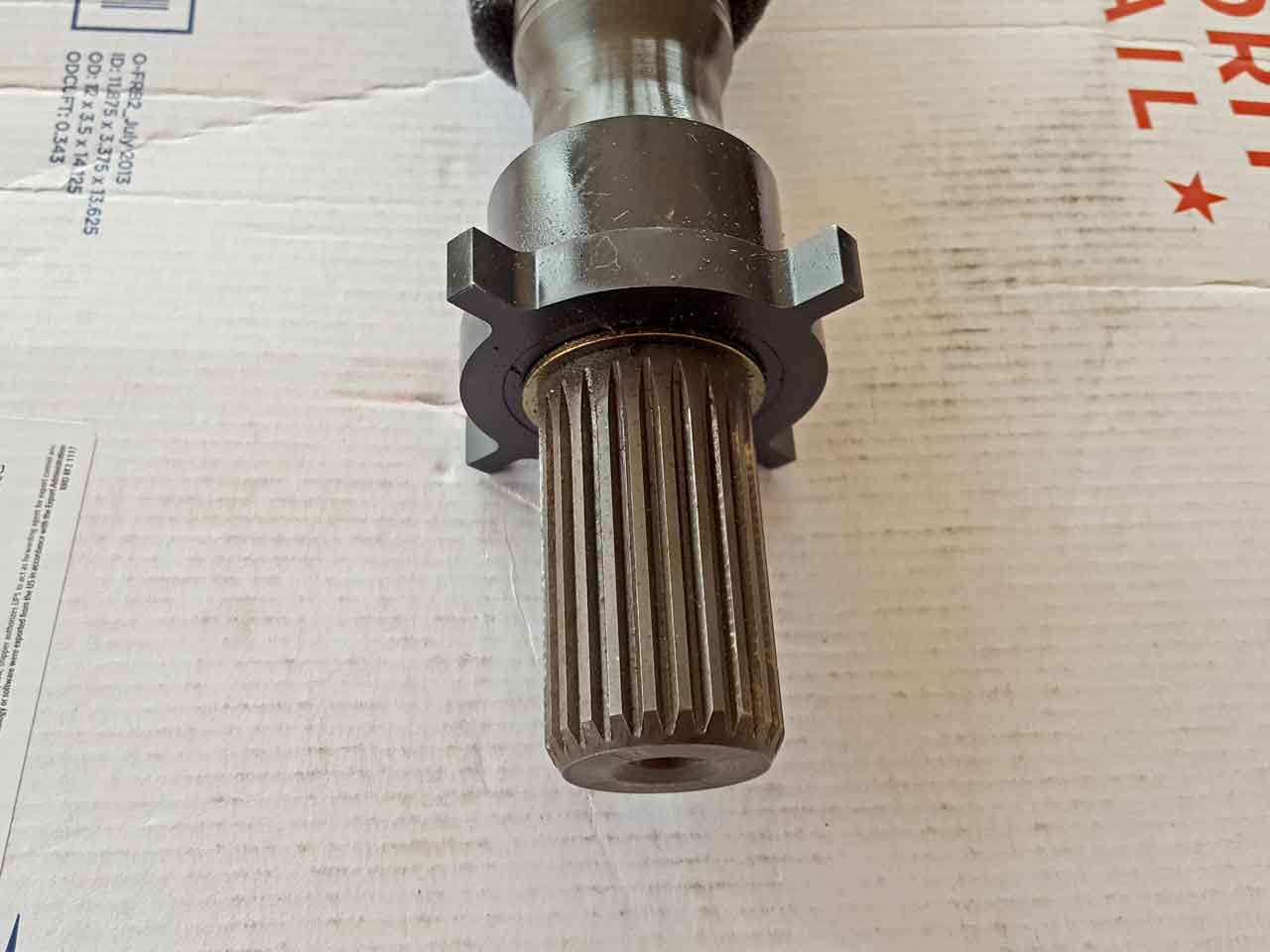

The five pictures below show the 1997-1998 Montero Sport V4AW3 transmission output shaft with the Mitsubishi 4 PPR reluctor ring. Note the keyway in the second picture. Don't do what I did and buy a shaft without the key (or loose it). I'm still looking for a replacement. smile

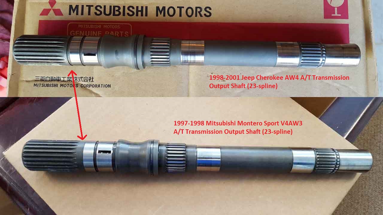

The three pictures below are of the 1998-2001 Jeep Cherokee 4WD 4.0L AW4 transmission output shaft and 4 PPR reluctor ring. Chrysler shipped a 4 PPR and a 16 PPR reluctor ring (at least that's what I've been told). I haven't seen a 16 PPR reluctor ring, so .... smile
Shown in the picture below is the difference between the Jeep output shaft on top and the Mitsubishi output shaft on the bottom. The '3rd', outer lock ring groove is missing on the Mitsubishi output shaft (see red arrows).
I have a pre-1998 Cherokee output assembly and I'll post pictures as soon as I have time. The differences between the pre-1998 and 1998-2001 Jeep assemblies were not clearly pointed out by anyone (or I'm just dense), so in a nutshell ...
The pre-1998 AW4 output adapter housing, output shaft speed sensor and reluctor ring:
1) The (Jeep) output adapter housing bolt patterns are the same on both sides, but the output shaft speed sensor and reluctor are totally different from their 1998-2001 counterparts. The parts are not interchangeable in any way. If you have a pre-1998 housing, you have to use the corresponding pre-1998 sensor and reluctor.
2) The pre-1998 output speed sensor/reluctor assembly is a 1 PPR setup, while the 1998-2001 sensor/reluctor assembly is a 4 (or theoretically 16) PPR setup.
3) The pre-1998 output shaft speed sensor and reluctor ring are completely different from later versions, and as far as I know are not even of the same type.
So, for anyone that's thinking of doing this, you need the following, all from a 1998-2001 Jeep AW4 (short snout 23-spline) ...
1) 23-spline AW4 output shaft with the third lock ring groove (and the half moon key)
2) Output adapter housing
3) 4 PPR reluctor ring and corresponding output shaft speed sensor (Chrysler calls this a 'Vehicle Speed Sensor', BTW. IT IS NOT the same as the actual VSS on the transfer case tail shaft housing.)
If there's no intention of using the output speed sensor stuff, the correct 23-spline output shaft and adapter housing are probably it. smile Since I'm going to use a TCM (the PCS unit mentioned further up), I kinda need the output speed sensor functional. smile

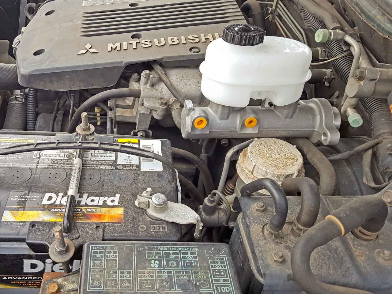

Re: Master Brake Cylinder Upgrade [Re: ES_97Sport] #1104266 03/27/18 09:59 PM
Originally Posted by ES_97Sport
Long time between updates but the project is still moving forward.

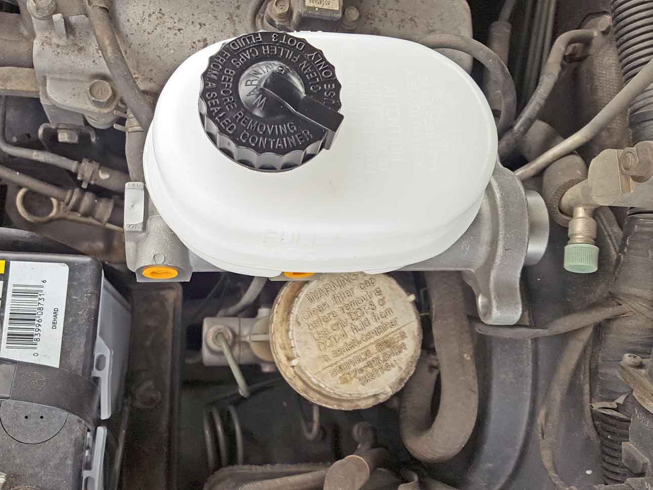

Brake master cylinder -
Raybestos MC390426 1 1/4" bore. This BMC is - ALMOST - a direct replacement. The flare fittings are a different size than Mitsubishi but that's easy enough. The unit is about 3" longer than the Mitsubishi BMCs. This means that the Group 65 battery will not fit in the standard location with this BMC installed. frown ....
The new BMC with a Group 34 battery. I lined the new BMC up as close as I could to where it will actually mount. There's about 3/4-1" between the BMC in my black Sport and my Group 65 battery. The gap here is about 3/4". There wouldn't be more than 1" between the new BMC and this battery - which is significantly shorter than a Group 65. smile

Two switch kits from Advance Adapters for the 2WD/4WD switch and Low Range switch. Note that these are the 300378 -A- parts for the post 8-2014 production transfer cases.
Advance Adapters speedometer gear for the Atlas transfer case. This is the 'short' (p/n 300637) speedometer gear for the Atlas electronic speedometer housing. (the mechanical speedometer housing uses different gears) This is the 39 tooth for a vehicle with 37" tires and 5.38:1 axle gears. It doesn't make all that much difference in my case because I'm using the SGI-5 speedometer converter from Dakota Digital and I could have ordered any gear and made all of the adjustments to correct the speedometer using the SGI-5, but I starting out in the ballpark is a good idea. smile
This is the last of the pieces for the transfer case. Everything is here and ready to go. STILL waiting on the axles ... sigh.
