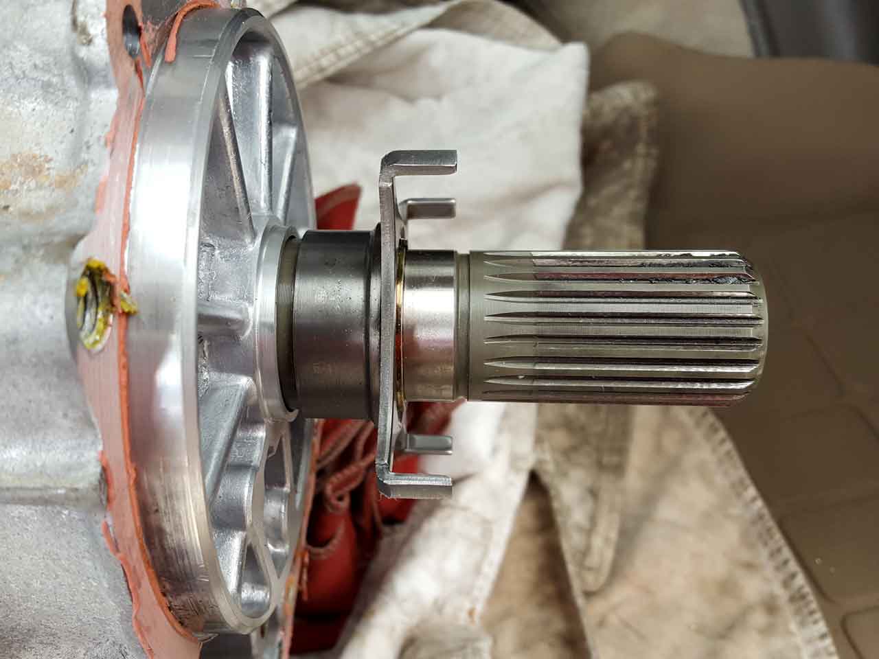

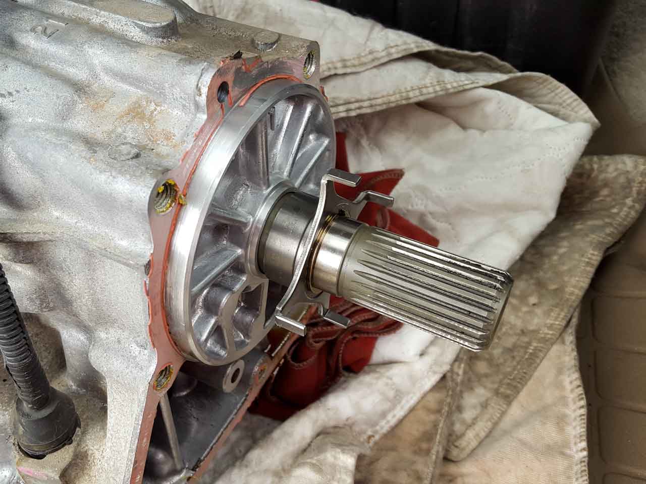

I picked up a spare V4AW3 from a 1998 Sport a couple weeks ago. I just got around to pulling the tail shaft housing a few days ago and found that this transmission already has an output shaft with the outside lock ring groove.
