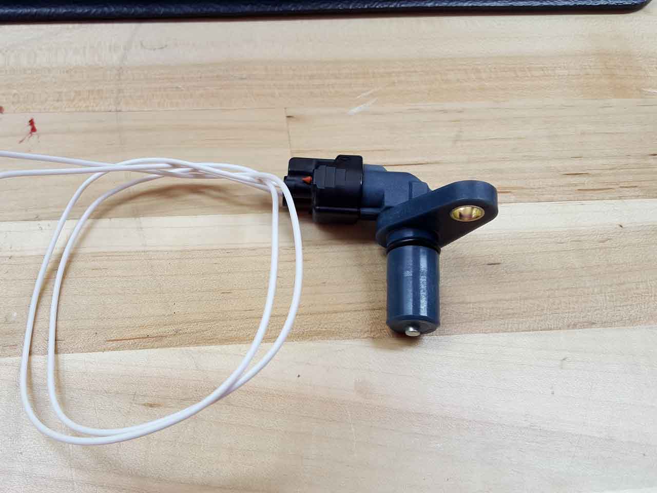

AW4 A/T output adapter housing 1998-2001 with the Jeep output shaft speed sensor (and a replacement connector/pigtail) installed.

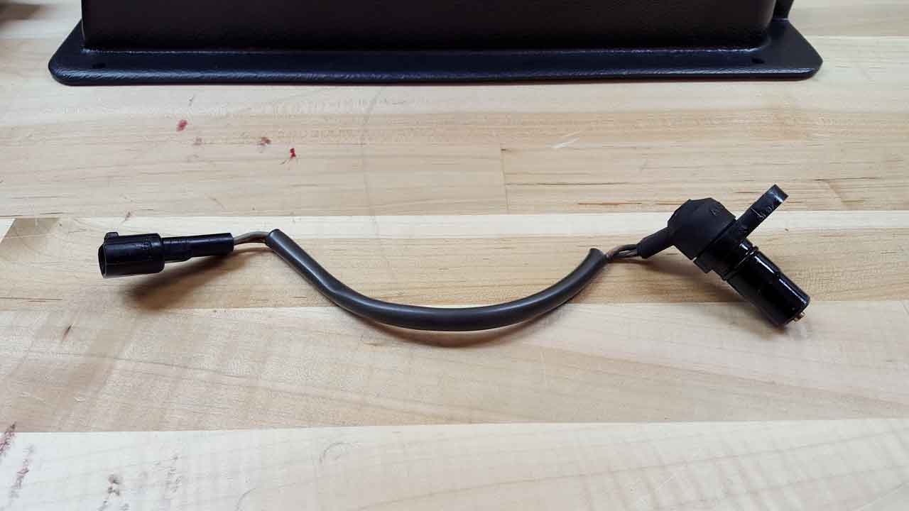

AW4 A/T output adapter housing 1998-2001 Jeep output shaft speed sensor.
AW4 A/T output adapter housing 1998-2001 Mitsubishi Montero Sport V4AW3 output shaft speed sensor.

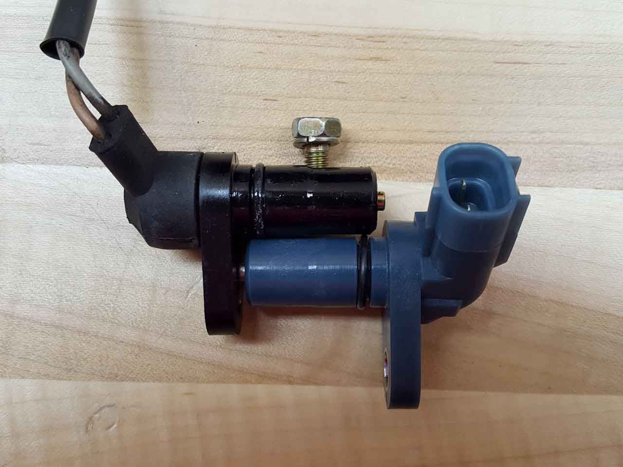

AW4 A/T output adapter housing 1998-2001 - Jeep 1998-2001 output shaft speed sensor and Mitsubishi Montero Sport V4AW3 output shaft speed sensor comparison.

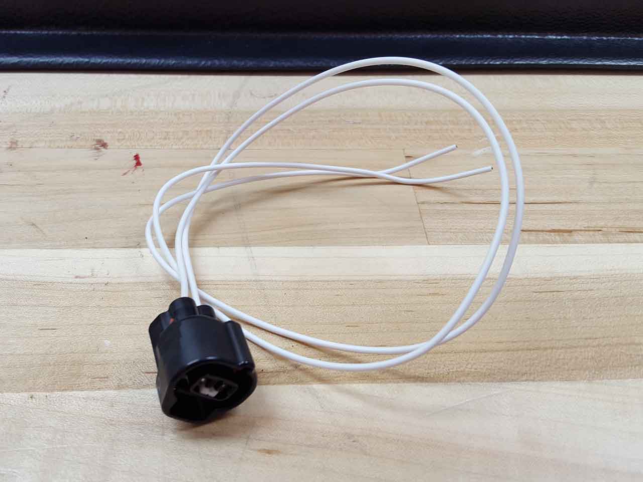

AW4 A/T output adapter housing 1998-2001 Jeep output shaft speed sensor replacement connector pigtail.
