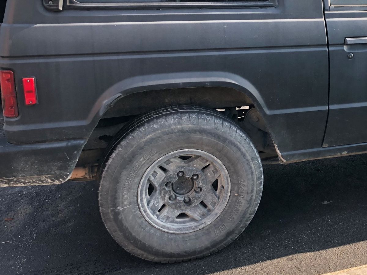

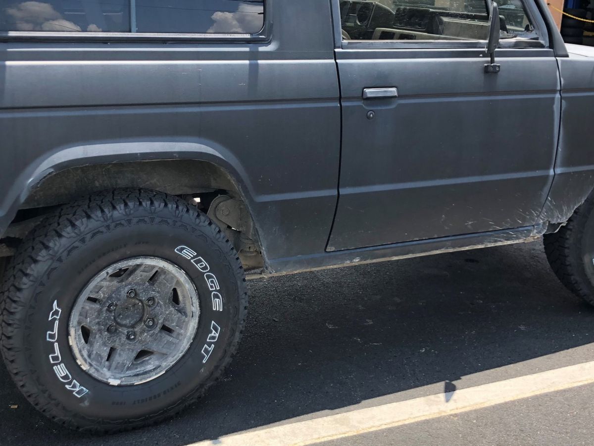

Finally decided to stop risking my life on the highway and replaced the old Primewells for something just a shade better, and definitely newer.

New tires look good, what size are they? I hope mine looks good with it's new tires, just gotta get it out of the shop. Having a difficult time being patient.

31x10.50x15, they are not OEM size but its what the PO had on it when I got it. The spare is the correct size but its also on an OEM rim, I debated pulling a set of original rims of a junkyard Raider I found locally just so everything matched but the Toyota rims that are on mine are wider, and frankly I was too lazy to lug a jack out to the back of the junkyard to get the other ones lol.
