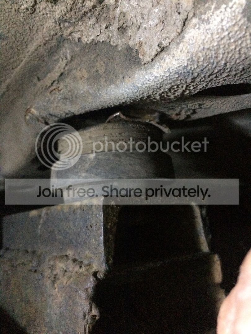

i hope it will take abuse better than the stock xmember, and help align the driveline better- still have to adapt the skidplate(s) to the new arrangement, but it'll happen.
this is the left bodymount(under drivers feet) that finished tearing off last season.
gonna metalglue some stiffener/mount stuff in there....
hmmml8tr
kinda crappy picture. i'll try again before i hack it up.

Tuxedo_Ranch Offline
OUCH! Looks like Suzi has a booboo. She must be a pretty tough girl'. We don't have much for rocks to crawl around on here in Kansas. Can be had in any direction but north, but it takes a minimum of 5 hrs. I'm interested in seeing how you do the repair so keep up the pictures (please).
