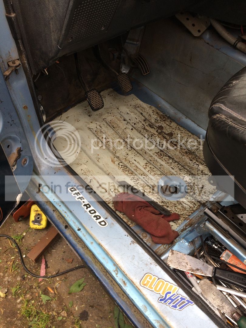

forgot to get a better b4 pic...sawsalled the mount bolt and considered what to cut next...
spent a lot of time removing the tar/vinyl sound deadening stuff from the floor, 'cause it makes a mess when it melts, and it burns well.
i have cut some angle pieces to replace that sheetmetal squash, and will build the mount point on that.
this will probably be better than the other side? mabe.
