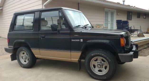

Found the only other Raider in Hutchinson and it was a lot cleaner than mine, so I bought it. IÔÇÖm now the proud owner of a 1988 Raider w/ AT, rebuilt 2.6 and right at 100k miles. Gave $2,500 for it but it will make an excellent run around vehicle for my wife for when we get her 2008 ÔÇÿBurban sold.
May have to post some pics for it later.

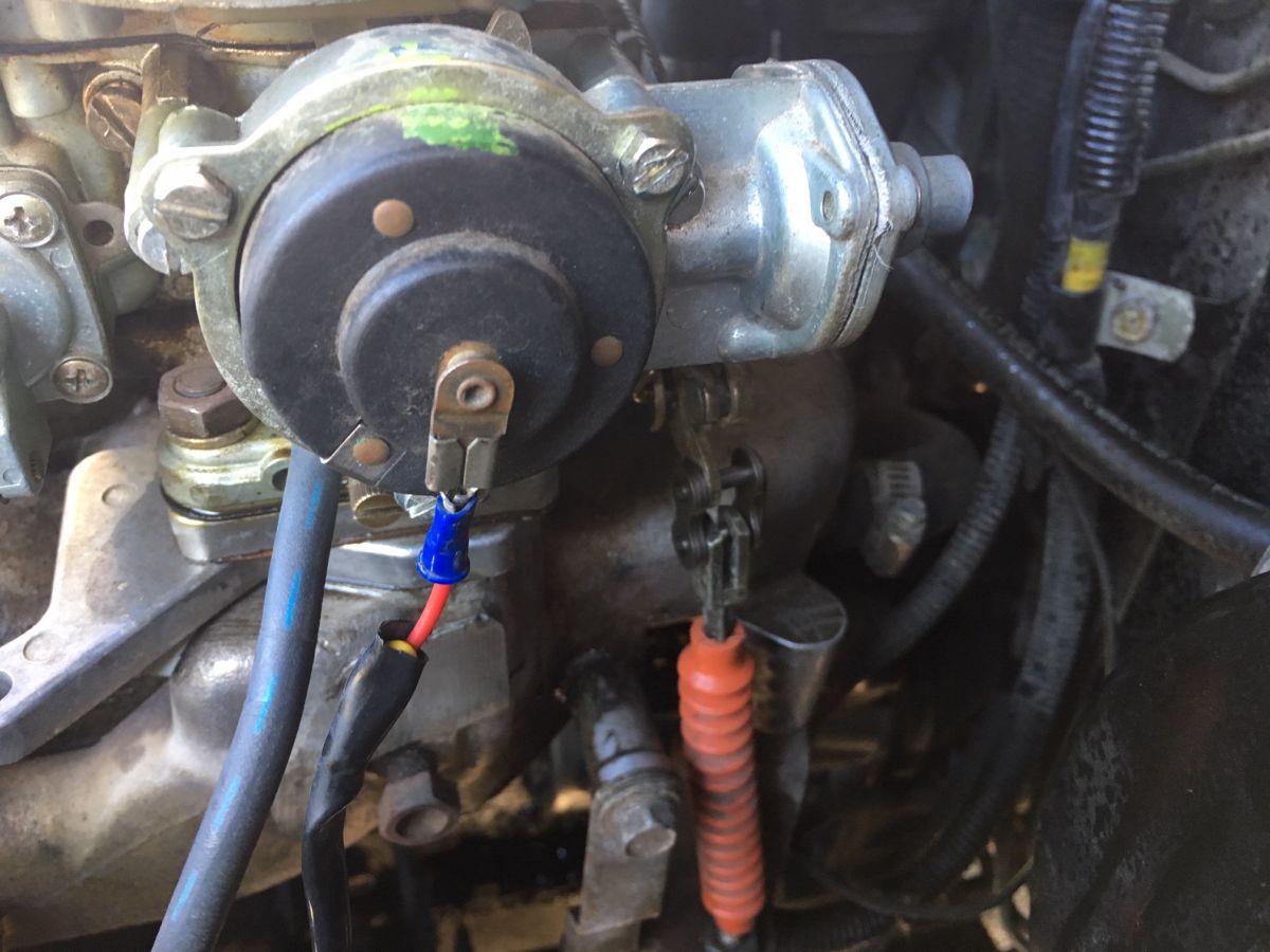

I spent all day re-working the throttle linkage, properly connecting the "kick-down" cable, installed Holley fuel pressure regulator and changing oil.
I re-used the throttle cable cam from the stock carb. I think I may have to do a little more work to get everything working properly, the secondary's aren't opening up and I don't know why (time for more research, anyone have any idea's??).
I read a lot of posts about how to connect the "kick-down" cable and found lots of things being done to fill the gap from the throttle cam arm to the cable end, from using a piece of wire to a zip tie. I wanted to use something a little more durable and didn't know what I was going to use. Last night I woke up with the perfect solution. I went to the local farm store and purchased a few different sized chain master-links, so I would have some adjustability in length. WORKED LIKE A CHARM!!! Tranny shifts perfect now.

Fuel pressure regulator went on quick (about 15 minutes), since I already worked through the issues installing one on my 87. Noticed the fuel pressure was "bouncing" between 0-4 psi (ding ding ding ding). I think I have a bad fuel pump and the local parts store won't have one until tomorrow. Hope that fixes the issue.
Last thing for today was adding 5oz of sea foam to the oil and running it for about 20 minutes while I sprayed the carb with Sea Foam to clean out the carbon. Did the "Hot" soak and re-run. Then changed oil and filter. I'm amazed how much smoother it runs.

Mama's Raider is running great now that I got the "kick down" cable properly adjusted and the carb tuned up. I was having a problem with the fuel pressure fluctuating between 0 and 4 psi. Couldn't figure out what the problem was but expected an issue with the existing fuel pump. Come to find out, the previous owner had installed the incorrect fuel pump trying to avoid using a fuel pressure regulator (BIG MISTAKE). It had a restriction on both outlets and wouldn't feed fuel fast enough to the Weber, so the bowl was running dry during acceleration. Also had a conversation with the PO and he didn't remember plugging the coolant port in the intake manifold that was used to heat the Mikuni carb. Gonna have to pull off the Weber and conversion plates tomorrow, to tap and plug the port if it hasn't already been done.
