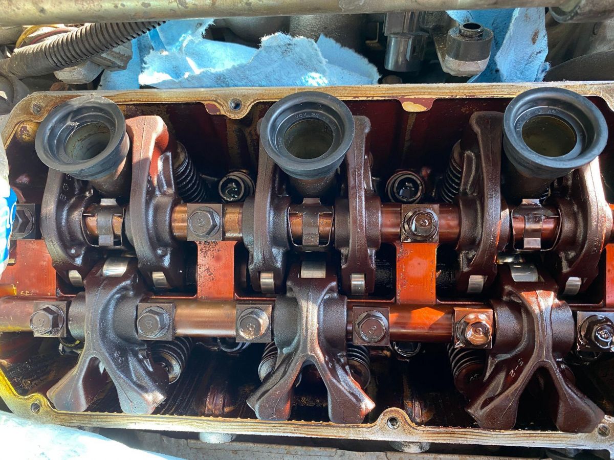

Started tearing into it this weekend but didn't get as far as i had planned. I'm finding the Montero to be a little challenging to work on but not too bad. I tore the engine down to the valve covers to replace those gaskets. Found more sludge and buildup than i was hoping for but nothing alarming. Took a peak at the T belt and microscopic cracks are visible, definitely needs to be changed ASAP. The previous owner wasn't big on maintenance it seems. Performed a compression test while I had access to the plugs.

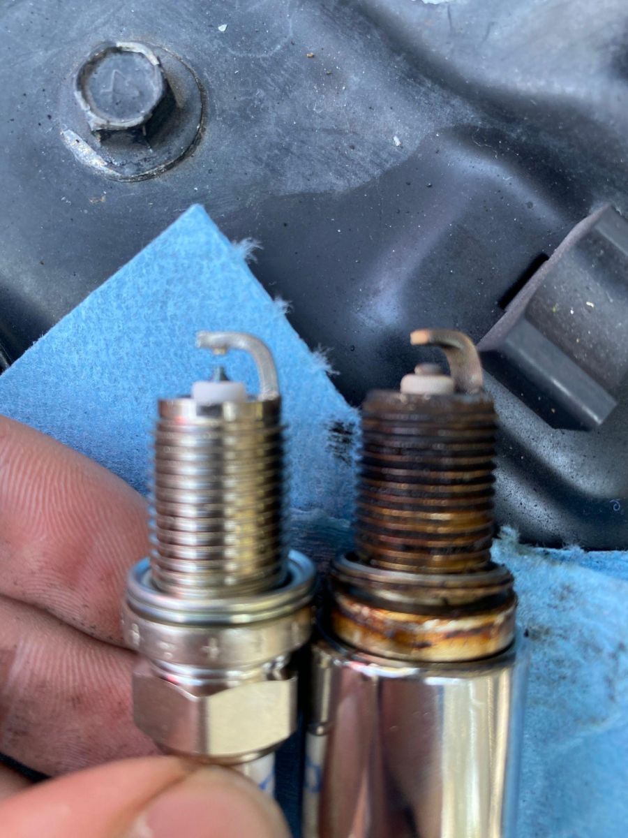

Changed out the spark plugs of course and they were looking a bit rough. Tonight I'm ultrasonic cleaning the injectors and rebuliding them. Then shes going back together.
Re: Flying 1000mi to buy a 97 Montero SR sight unseen [Re: Macdrew77] #1105730 09/28/20 02:43 AM
Joined: Sep 2020
Posts: 10
Macdrew77 Offline OP
Thats one of the better plugs that came out. And a shot of inside the valve cover.
