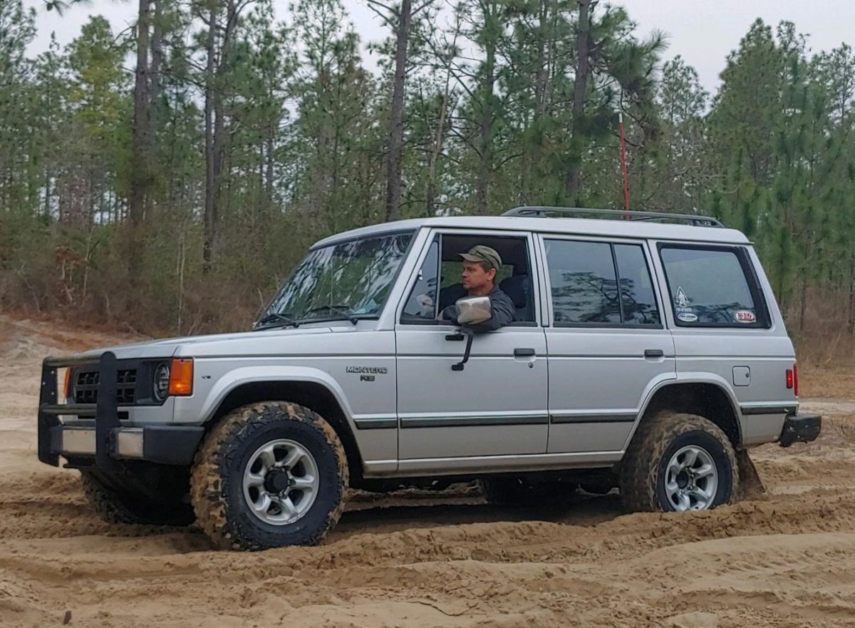

Drove it today with the rear bar removed, actually cant tell a difference in driving, the new shocks may also have helped.
Slight bit more flex, but i still have stock length shocks.
About to disconnect the front and see if she gets wobbly on road. Would definitely help offroad, not looking to increase wheel travel, just let the front do its job freely, its an Independent front.
Stock length shocks and stock bump stops. Cant over travel and bust a joint right ?
More aggressive tires and weld the front diff will make a huge difference though.
Thats later.

Ok i test drove it yesterday, didnt see any difference with the rear removed, but i can with the front removed, but ! Its a truck, i will never drive it on the interstate, i wont be driving fast, it doesnt sway and lean all that bad anyways, plus, its a truck hahaha.
Front suspension can now be Independent now.. doesnt have any more travel, just lets it move a bit freely.
I love it. Actually rides better offroad as well.
Now if i could get around to welding up my diffs she would be an offroad beast .

Took it wheeling today, flexed all i need to for now. Stuffs a 31 in the fender well and maxed out the rear shock till it liifted a rear tire. Front bottoms out on the bumpstops up and down.
All in all im happy with it.
