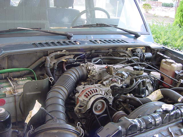

That's the alternator stay bracket - you can see it in this picture, peeking out from under the intake duct:
Frank
This is what mine looks like by using a crap load of parts cleaner, remeber it had 320K mile and was blowing oil out everywhere before the rebuild. Did you actually polish yours? <img src="/forums/images/graemlins/kewl.gif" alt="" />

What connects to the vacuum line comming off the intake?
John Pszenyczniak
67 Mustang Coupe
95 Firebird Formula
05 Ram hemi 4x4
91 Montero RS LWB w/ 320k miles before rebuild, 900 down and its still kicking!!!
Re: WTF, Extra parts and it won't start.. [Re: johnpsz] #653293 10/06/05 12:06 AM
Posts: 10,238
FrankR Offline
A vacuum line goes from there to the lower port on the solenoid purge valve located on the driver side fender below the purge canister - directly across from the tube in your picture.
