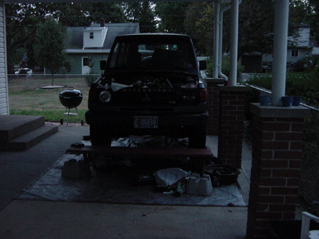

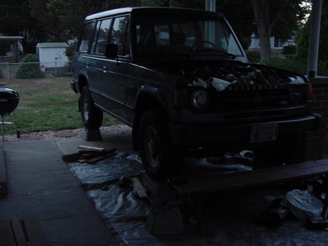

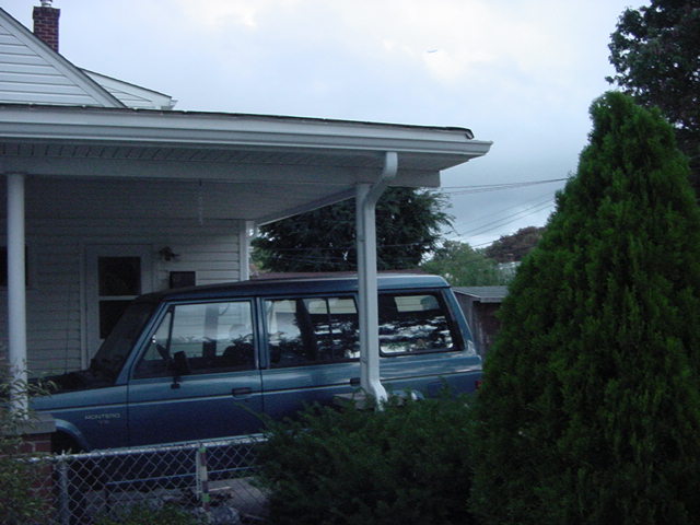

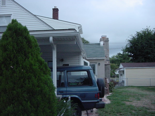

Re: WTF, Extra parts and it won't start.. [Re: off-roader] #653308 10/07/05 12:15 AM
Joined: Jul 2004
Posts: 194
johnpsz Offline OP
Yeah it has rained, some were bad storms.. But no the truck wasn't fully under the carport...
Actually I didn't even realize untill I just went out to take a few pics how much it was not under the carport... Sorry if these pics are dark it is getting dark out here.
