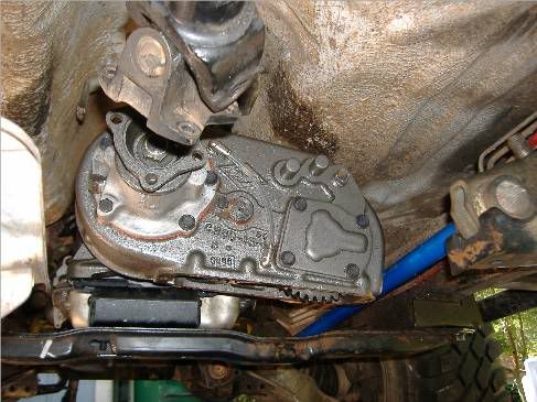

I got the tranny mount finished up as well.
I loosened the engine mounts and put a wooden spacer between the torsion bar and the case. I only had to re-drill one hole for the transmission mount. Once I bolted everything up, I pulled out the spacer...

The only issue I'm having is with shifting the T-case. I started with both outputs in neutral, and was able to shift the rear into high range, but that's it. I'm afraid to pull any harder on the shifter, and it won't budge. The tera gears came with four poppet spring shims. The reason being that when a twin stick is used, it has a tendancey to pop out of gear (or so I understand). I installed one shim under each spring. I'm going to call Northwest Fabworks in the morning to get their advice.
