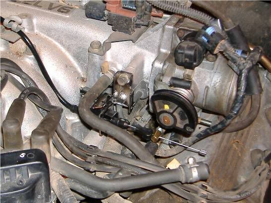

All these "little details" that I've been putting off now seem to be the only things left to do <img src="/forums/images/graemlins/scared.gif" alt="" /> I was fitting the throtle valve cable tonight, and came upon a snag. The first TV cable I got came up a good bit short. I stopped by the transmission shop the other day, and got the longest one they had. This one measures 45.2", and is still about 6" short <img src="/forums/images/graemlins/angry.gif" alt="" /> I need to find a longer one somewhere <img src="/forums/images/graemlins/confused.gif" alt="" />
I was thinking about some sort of linkage extension, or some way to add an extension to the cable <img src="/forums/images/graemlins/confused.gif" alt="" />
I figured I could get the throtle end figured out if nothing else, so I test fit the cable and bracket
Here it is without the throtle in place
You can get an idea of where the stud needs to be to mount the cable. I'm thinking about a flat piece of steel that I can bolt to the plastic throtle arm in two places. Should be plenty sturdy.

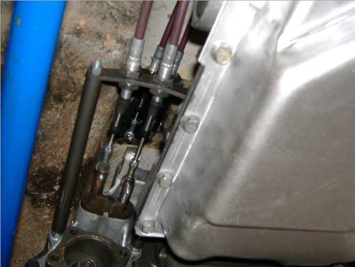

I also trimmed my transmission pan to clear the driveshaft
And one of the weights the shop used to balance the shaft was looking to be pretty tight
I decided that I'd rather have a little more clearance than a perfectly balanced front shaft <img src="/forums/images/graemlins/pfft.gif" alt="" />

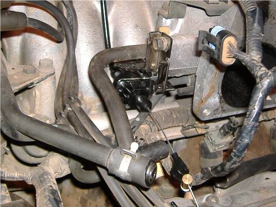

I managed to re-route the TV cable and get everything to fit.
This piece is made from a piece of 16 ga steel
and mounted on the throttle body
Everything painted up and re-installed
Here is the clearanced tranny pan installed
