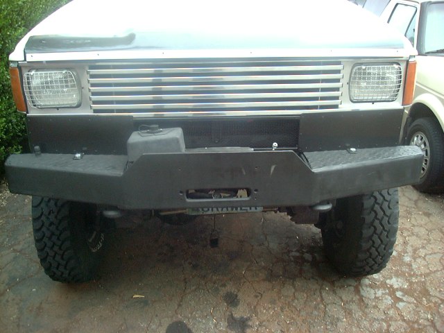

Here is my front bumper:
One of these months, I plan to relocate the winch control box off of the top of the winch and behind the grill.
