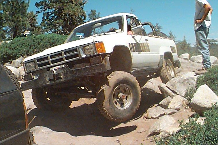

I want to try to stay away from the block's and my stock one's I got on this truck are actually litterally flat so...kinda why i was thinking of getting some leaf's custom arched, then putting some shock's in too for helping articulate/ride along with maybe a coil. Not so much worried as cheap, but dont wanna go spend thousands to do it ya know?
Re-arching stock springs is one thing, getting new springs custom built is another. If you can get some made to meet your needs, that is fine. I've run two different sets of custom built Alcan springs, they make them to meet your load and lift requirements:
- http://www.4crawler.com/4x4/4R_suspension-III.shtml#LongerRearSprings
They work way better than most anything you would get off the shelf. Here is a 3.5" lift spring setup (off the shelf), pretty much flexed out:
Here is the same 4Runner with some rear Alcans and stock rears up front:

Mine is an '85, came that way from the factory for the most part. Front springs were essentially free, half the pack came off the rear axle when I replaced those with the Alcan springs (about $450, shipped, for the set) and the other half of the pack came from a buddy's pickup when he replaced his stock springs.
