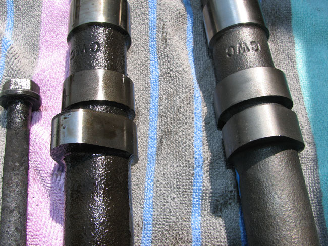

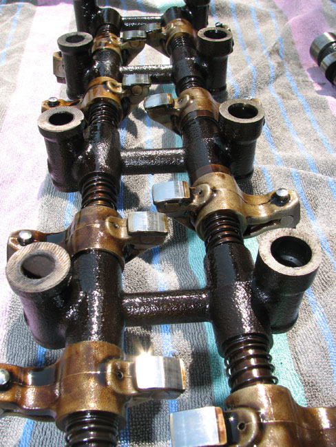

When I pulled the 270 cam, I inspected the rockers, adjustment screws, lobes, and journals. Everything still looks brand new except the leading side of the cam lobes are all polished. I think that's normal for cam wear, but correct me if I'm wrong. All lobes showed this wear on the leading side. There weren't any gouges or ridges on any of the machined surfaces. Timing chain and guides still look good too.

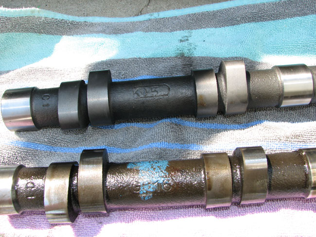

EB I am curious if the 270 cam was ground from the same castings as the stock spec Melling. The casting looked identical and I could only find one stamping that was not the same between the two. I took a picture to show the lobes and also the stamped numbers that were different.
Here are the stamped numbers that were different (bottom is EB270 cam "G 16", top is Melling stock cam "K 5".
Here is the lobe wear after 30k miles on the EB cam (left) versus a new Melling (right) Like I said, I think this is pretty normal cam wear.
Here are the rocker and adjuster screw surfaces. They looked polished, but no scrapes or gouges

>>>*Melling doesn't make camshafts of course. They buy them from that company, CWC (which is a mirror image of CMC.)
You will find about 90% of all camshafts sold, including nearly 100% of domestics and the vast majority of imports sold by the aftermarket will carry that logo.
American made stuff. We seldom use them anymore except as backup, ours are either TSU which will have just numbers, no letters, or TAE blanks now, everything we have is special ground except for the stock ones.
Yes, wear appears very minimal, of course the rocker pad drags on these so they will shine in...*EB
