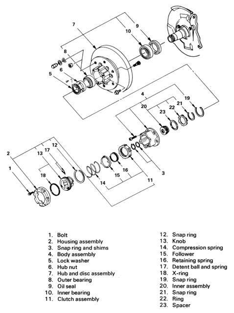

Are you talking about item numbers 5 and 6? If so, item 5 is part number 8-94442-398-0 and item 6 is part number 8-94442-399-1. The 3 screws have part number 9-93090-408-0. Double check on the screws part # with whoever you order from. I ordered the screws and when they arrived, the heads of the screws were rounded and would not sit flush. The screws you need are flat headed machine screws. Hope this helps

yeap 5 is what i needed and got it ordered!! what is the best way to tighten down the hub nut?

didn't i mention that already? you can just spin it with a flathead screw driver and a light tap from a mallet. you're not gonna crank on it, just enough to get a light preload in the bearings.

i got the lock washer but it doesnt look right, looks too small...i will find out this weekend
