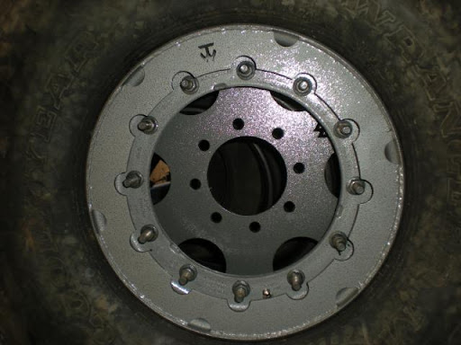

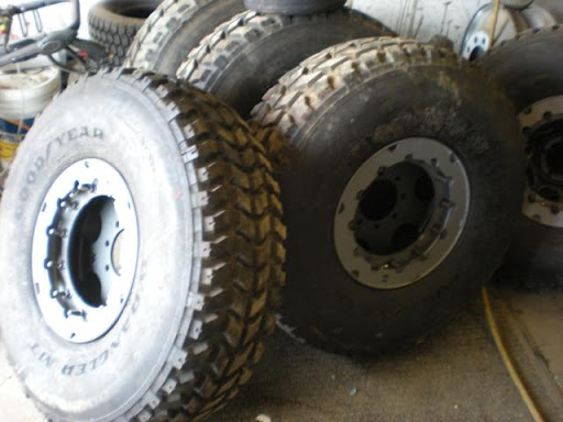

Re: Building da Beast at Oyaji Jon's house [Re: Oyaji_Jon] #937123 06/02/09 01:09 AM
Posts: 3,272
Oyaji_Jon Offline OP
Pictures of the wheels/tires that are enroute. The rims are powdercoated in hammered silver and inners in hammered gray. I'm excited to get the meats on the truck!
