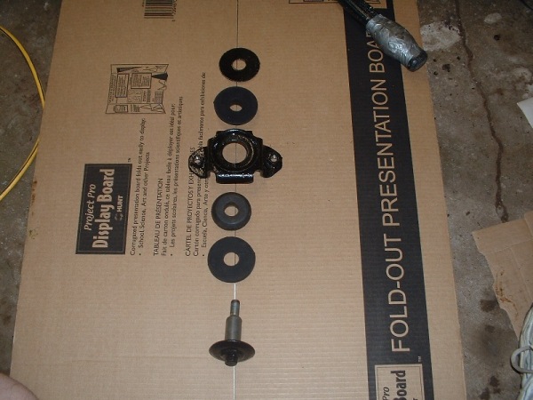

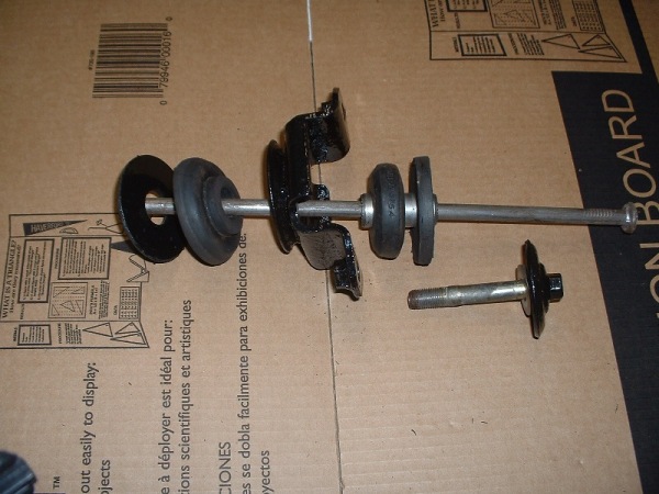

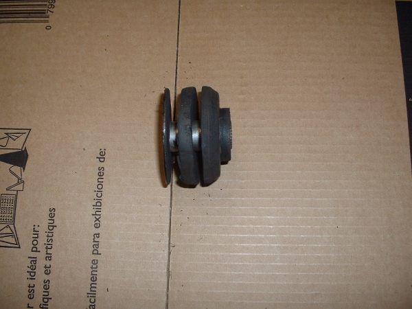

...Now trying to figure out how much to trim out of the gen 1 isolator...
Here are a few more pics, FWIW. I should have put a tape to the parts when I snapped them. <img src="/forums/images/graemlins/rolleyes.gif" alt="" /> (The third pic has the parts all strung on a long nail/spike so that they would show the edges better.)

What I do remember is that I used a hole saw to open up the cross member to let the rubber isolator drop down further. This also helped with the pinion angle. I know I did some welding as well.
I did move the bracket mounting points so that I did not have to drill the tab on the pumpkin.
Obviously both way work.... ItÆs all about preferences.
