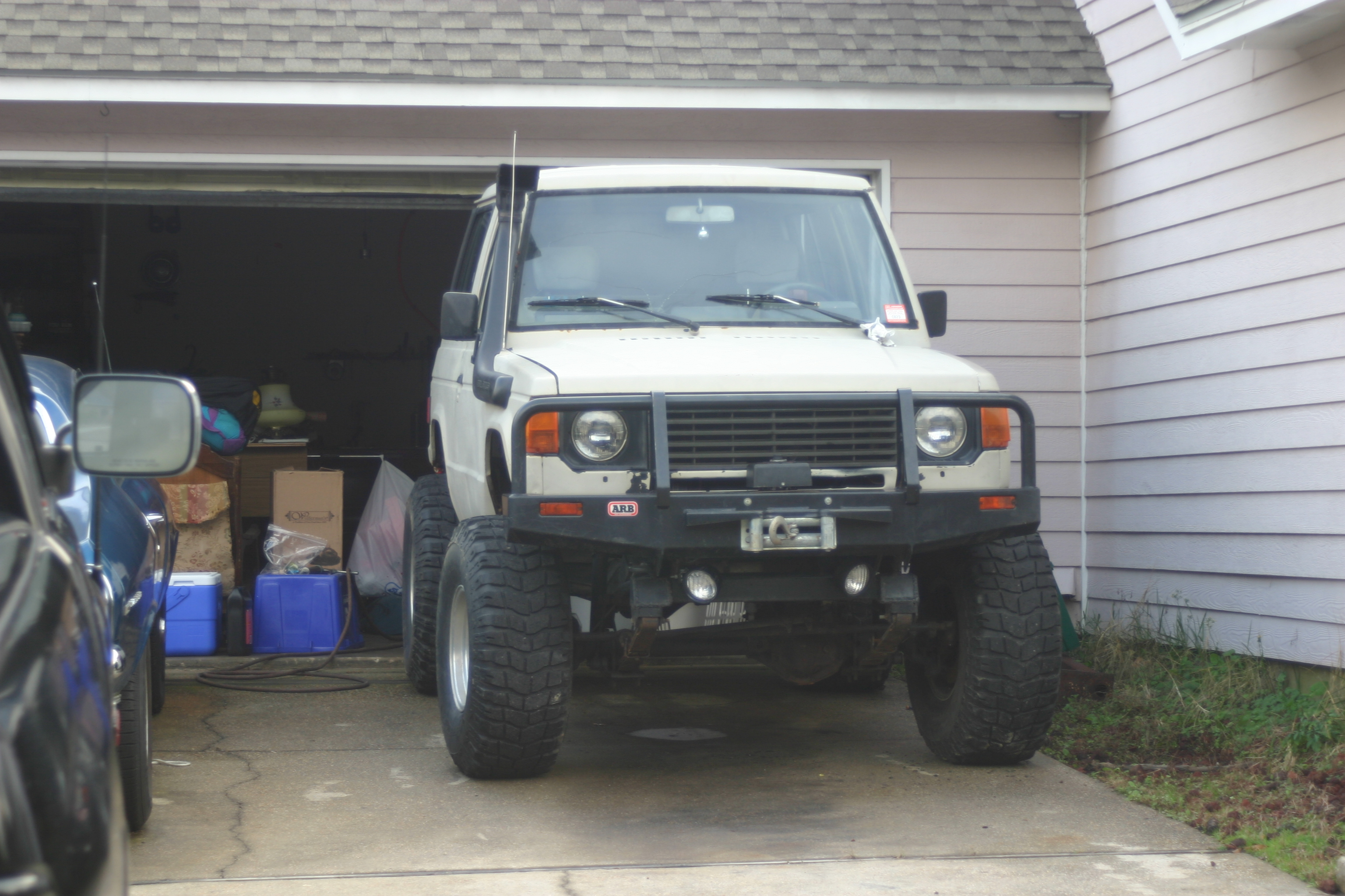

I had this exact same question for my 1989 V6 SWB. Sounds like the Gen II bumper is the best one to modify if it is a V6?
Justice, do you have any other pics of this truck? I am curious about the width and how it lines up with the fenders. I like that the Gen II bumper wraps around the front where the Gen I does not.

Posts: 3,269
justice Offline
Check out my thread, "Project El Gato" for more pics.

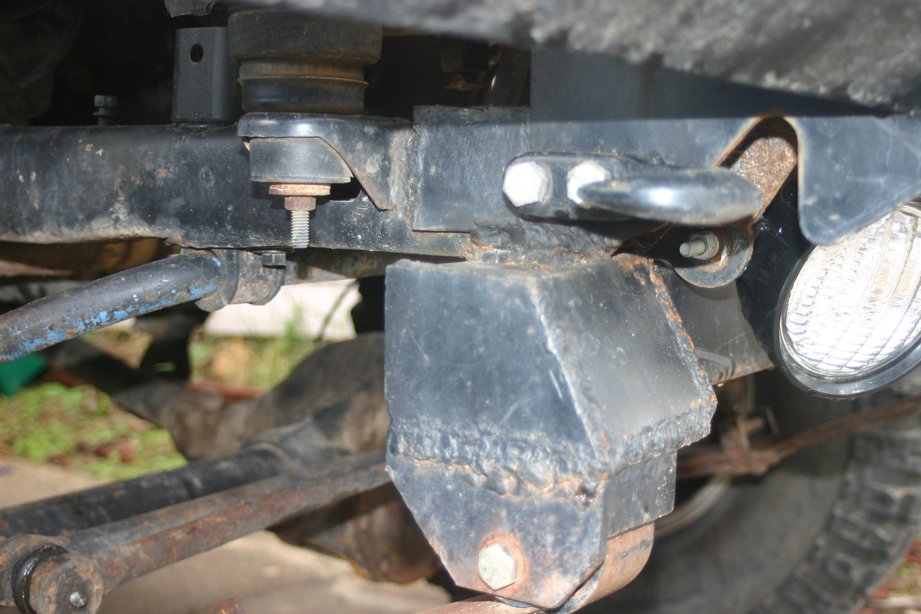

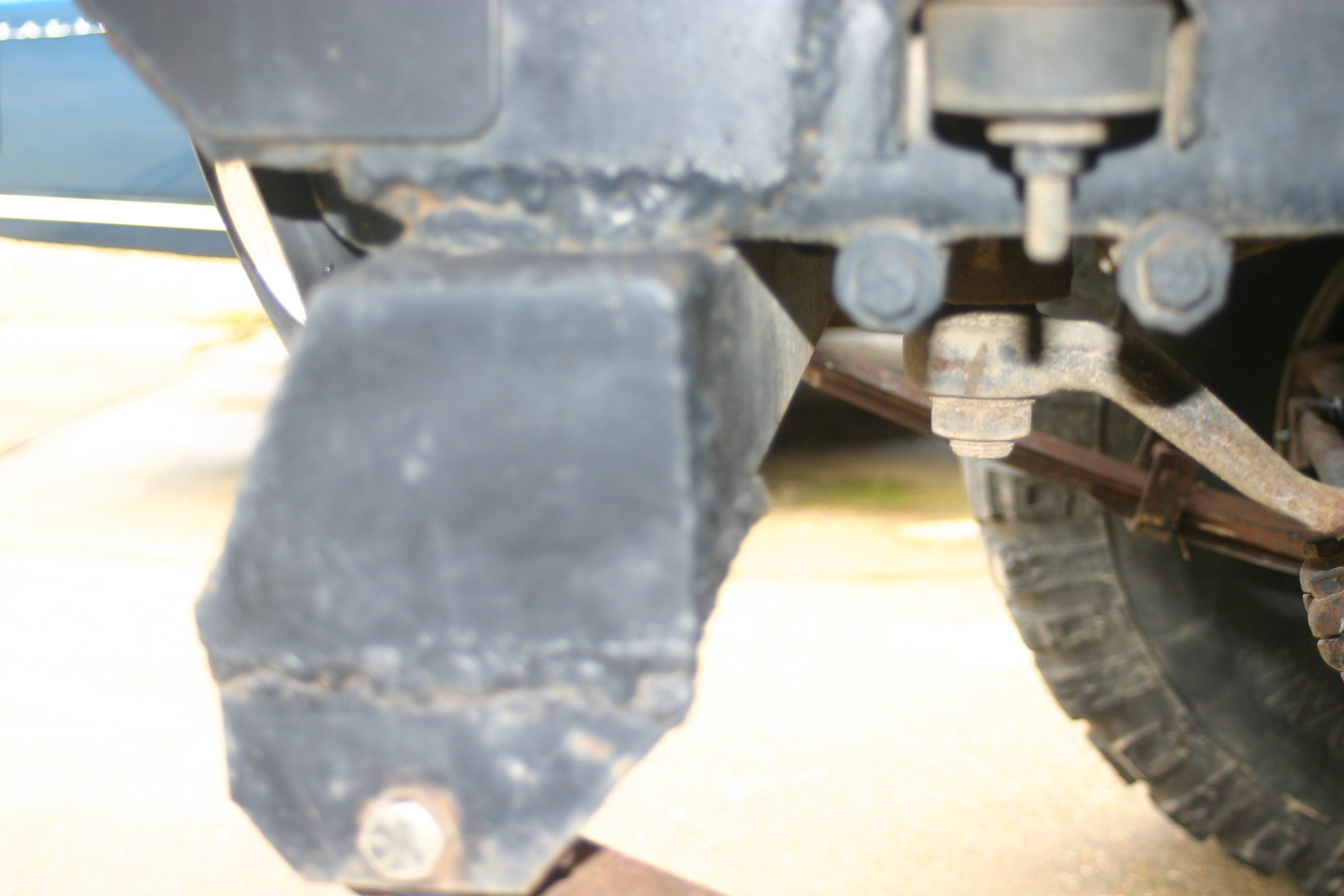

I also have a Gen1 with a Gen2 Bumper on it.
I modified my frame rails to fit. I basically welded plate on my frame, and built Gen2 Frame horns onto my Gen1 Chassis.
Re: Gen 1 ARB bumper found in US but one question [Re: LandRaider] #994357 04/22/10 01:16 AM
Joined: Sep 2001
Posts: 8,557
LandRaider Offline
http://alliedpaper.org/landraider/SASpics%20%285%29.JPG
Kindy Blurry, but you can see the plate welded to the frame.
http://alliedpaper.org/landraider/SASpics%20%2818%29.jpg
Here's another view.
http://alliedpaper.org/landraider/SASpics%20%2815%29.JPG
Thats a good overall shot of it.
